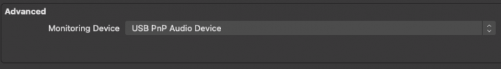

i am also having the same issue, though my monitoring device is set to the wanted route, it does not go out there,
i am using a baseus usb Dock, but when i place headphones in my macbook it detects them right away,
but when i play spotify music goes out from the hub.
i hope OBS can resolve this...
