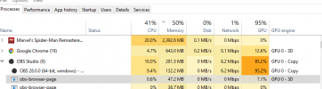

I apparently have malwarebytes installed and scan regularly and haven’t had any thing pop up on my scans. The system manager doesn’t pop up often when checking task manager for problems. The main think I see is my obs shooting up in high GPU usage when a game is open but I haven’t even hit go live. Could this be an issue with maybe something in my setup or a possible bios issue?
OBS isn't using that much GPU and isn't involved at all with that usage on the desktop windows manager, with the exception of it's own window render or whatever is called.
You have a process abusing on the GPU for unknown reason. You have to dig in what is happening in there.
Heres a image of my task manager showing obs at 95% GPU no device manager adding to it.
Download the zip file of OBS, create a portable version and see if this still happens when you open it with no scenes and default settings.
Please post a log file from when OBS is using that much GPU. Also, the image is cut short not showing all the processes.
