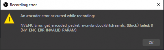

Hello, as the title suggests I have been getting an encoder error ever since I installed OBS.
The frequency of this error is completely random, sometimes pops up after 15-30 mins of recording or streaming while other times it would not even initiate the recording. Restarting my computer seems to solve it for a little bit at times.
I have checked other forums and posts regarding this issue, I can't seem to find a solution for my case.
Attachment: Error Screenshot and Log file from OBS.

You're using SE.live. Please contact them for support.
Alternatively, uninstall it. Then uninstall and reinstall OBS in order to fix the changes made by SE.live. Now please do a test stream/recording of more than 30 seconds and post the log file here.

This is a different issue.
You hit an encoder error. Restart your computer and try again.
Also, for recording use CQP instead of CBR or VBR.
I restarted my PC multiple time and it produced the same result every time, it started happen since yesterday only. (works for a couple of monutes and then the error persists)
Downgraded my Nvidia GPU drivers (with DDU) and it seems to have solved the issue for now.
