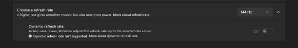

OBS not wanting to make my video 144 fps, it makes the video 60 fps instead, on both preview AND video
this is what it looks like before i record
i move the window and my mouse, and the preview makes it seem like a footage thats 60 fps, rather than 144 fps. the preview is not smooth at all compared to what i used to clip a while ago. YET at the bottom right, it says its recording at 144 fps, so i dont even understand why this is going on

OBS isn't causing your issue, your laptop or settings are. I'm kinda thinking there may be some thrashing going on. System only has 16GB of RAM & you're writing to your OS drive. If that drive is getting full/near full, performance will slowly degrade.
i tried recording at very low settings and the issue is still there
is it maybe because i keep my laptop on its A-game and not giving it rest?
my RAM currently is 46% so even if i have nothing on besides obs, shouldnt it at least show 144 fps while having nothing on besides the recorder?
i sadly dont have a 120z option for my monitor, i looked in both nvidia control panel and the windows settings.. the only other option i have is 60hz
also which drive? the C:?

Hopefully things runs smooth @ 60, if not easier to troubleshoot. Once 60 is stable, we can try to figure out why the high refresh rates aren't doing so good
I'm going to need a complete log.
Make system updates with OBS closed.
Make updates to OBS & then close it.
Re-open & run your test. When finished close/re-open OBS & post the previous log.
