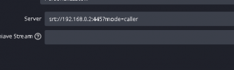

Through netstat i found which IP and port have both but once i digiti in OBS it pops that the connection it's not available.
Attached some screen, maybe there's something missing or that i didn't understand.

Are you sure the Input IP is correct? 192.168.0.1 is usually for the router.
Well, yes, i set it manually and router has 192.168.0.20 i guess the problem is in the port. I'm not able to show the port from the mac.

Yes, that looks good. If the router has a 192.168.0.1/24 interface, the networking is OK.
Have you updated the srt:// URIs in OBS with the correct IP addresses?
Where did you get the port-config information from? In some cases you would need "special permission" to listen on the higher ports--try something below 10000.
I found it via NETSTAT with CMD but what i didn't get is, is it necessary to use a specific port or it's enough to use anything i want?

The 'Server' is the "listener." It is streaming on a specific IP:port. The Client (feed-consumer) is the "caller." It has to call the IP:port of the Server (listener) to receive the stream.
The port you use (you must choose it yourself, it cannot be already in-use) should be the same on both sides, and the IP used by the caller should be the IP of the 'Server'. Here are some screenshots. Maybe you should test your 'Server' with VLC to make sure that part is working locally and remote, outside of OBS:

Great, turns out that i switched caller with listener. But now when i start from caller pc it says that something unexpected encorred and i have to read the log file. Where the heck is it!?
You should confirm that it works with VLC before trying to get it working in OBS. I don't know where the logs might be, but you shouldn't need them if you just take it step-by-step. You might have a firewall enabled on Windows. Check that kind of stuff test. Make sure you're using the right IPs and port.
