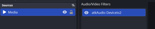

My test setup is a collection with one scene which has one source, a media source which has one DeviceIO2 filter
This is connected in Exclusive mode to a single VAC line which in this case is provided by the free VAC Lite software.
Connecting to this in Voice Meeter potato I get
trying to record from that channel in Audacity I get

I'm still not able to connect to Voice Meeter or record from an exclusive VAC line in Audacity.
