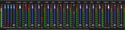

I use Audio monitor for a lot of audio managing on my PC, and was wondering if a hotkey could be added to restart all outputs at once, instead of having to manually mute and unmute outputs, or my current method of just restarting OBS, which restarts everything at once​
...restart all outputs at once, instead of having to manually mute and unmute...​
